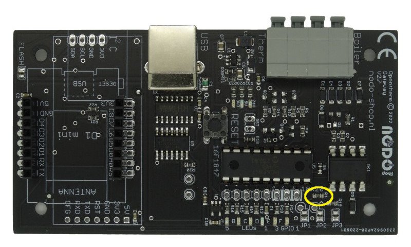

How good are your eyes? Can you check what is written on R4? That's the SMD resistor circled in the image below.
The two most likely numbers on there are 271 and 331. Yours should say 271.

hvxl wrote: Tue Sep 20, 2022 12:18 am How good are your eyes? Can you check what is written on R4? That's the SMD resistor circled in the image below.
I don't know about my eyes, but my smartphone camera works surprisingly decent in subpar light conditions.
Resistor R4.png (21.77 KiB) Viewed 2998 times
As expected and shown, it is 271.

Thanks. Then I'm not sure what causes the low voltages from the boiler interface. Maybe variations in the components. I'll try to figure this out with the Nodo shop.
