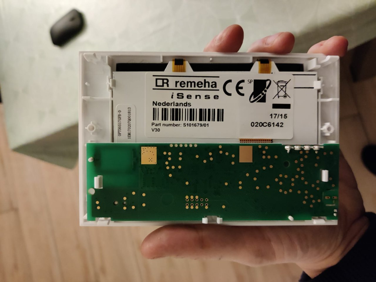

I've also attached a picture of the back of my iSense with all labels/markings

- back of my iSense V30

If the sticker says it's V30, then it probably is V30. To check it via the menu, do:

Hi Schelte,
Thanks for the info. I did not realize V30 was the firmware version. I thought this would be some kind of hardware revision.
After enabling the remote input I can indeed set the temperature from Home Assistant. Great!
