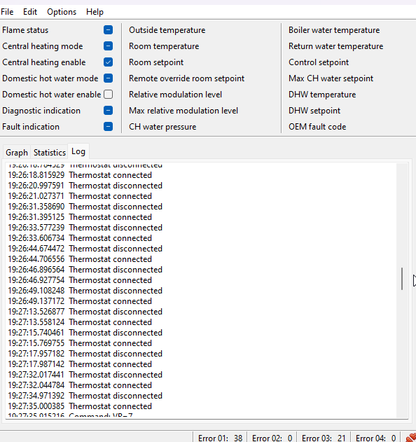

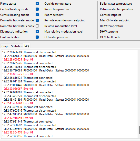

The thermostat turns on and off continuous (and shows nothing on the screen) and after playing with the voltage the log shows error 1 and 3 alternately. (see attachments)
2023-09-04 19_35_27-Opentherm Monitor.png (52.6 KiB) Viewed 2061 times
2023-09-04 19_35_06-Opentherm Monitor.png (49.04 KiB) Viewed 2061 times

For now the screen shots will do. But for future reference: When I ask for a log, I mean a proper log file that you create by going to Options -> Logging. Configure the Logfile section and enable it. Preferably leave the "Include details of bit fields" option off. It only makes the log larger, but doesn't provide any additional information. If it's a small log, you can copy&paste the text as a code block into a message you post here. In case of a larger log, compress the file (gzip, zip) and attach it to the message.
You didn't provide context with your screen shots. Is the second one supposed to be taken without a thermostat connected? In that case it is strange that the OTGW frequently reports "Thermostat connected". Also strange are the "Error 01" reports. By default error 01 is disabled. Did you enable it for a reason? If not, go to Options -> Settings and activate the "Ignore multiple mid-bit transitions" option. Hopefully that will help to receive the responses from the boiler.

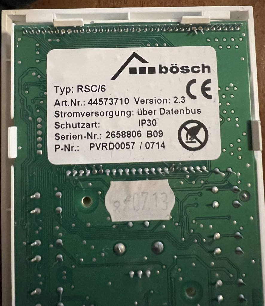

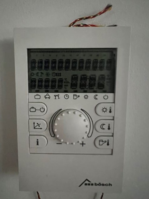

Does your thermostat work when connected directly to the boiler? Someone has uploaded a log file for an Atag BrainZ RSC V3.0 to the equipment matrix. So, in principle, the thermostat can work with the OTGW. Please confirm that it definitely is a BrainZ thermostat, not a BrainQ.

After some research in the internet with the product number (see attachment) you are probably right. Its a BrainQ.
Is this a show stopper?

If I understand the manual correctly, the BrainZ uses the OpenTherm protocol, while the BrainQ uses a proprietary (modbus) protocol Atag calls T2B. The OTGW only works with OpenTherm. So, unfortunately, a BrainQ thermostat cannot be used with the OTGW. Unless Atag has a converter.
