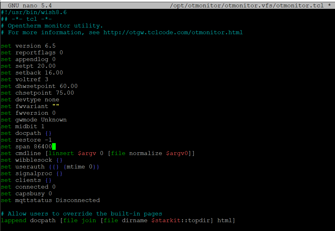

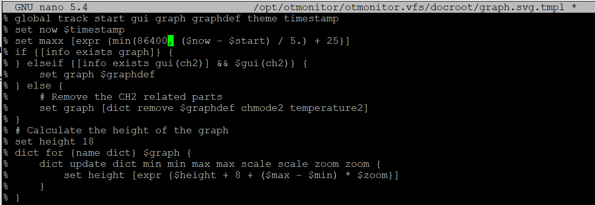

---- MOD GRAF 24h ----
sudo nano /opt/otmonitor/otmonitor.vfs/otmonitor.tcl
# change set span = 86400 (t.j. 24h)
sudo nano /opt/otmonitor/otmonitor.vfs/docroot/graph.svg.tmpl
# change row 3 to min(86400, (t.j. 24h)

Bororo wrote: Tue Nov 14, 2023 8:02 pm ---- MOD GRAF 24h ----
I suppose this will not work for the webpage (graph will not update after 2 hours).
