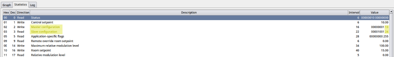

At the moment I am revamping the OpenTherm Gateway Home Assistant integration. One of the things I would like to improve is to be able to show manufacturer names based on the Member IDs found in the OpenTherm protocol.
As I don't have access to all brands of boilers and thermostat, I can only determine the member IDs of very few manufacturers. My hope is that people here are willing to share their knowledge and values for this. You can find the values on the "Statistics" tab of otmonitor at the end of the "Master configuration" (for the thermostat) and "Slave configuration" (for the boiler) rows, highlighted in yellow on the following screenshot:
What I need are those values and the name of the manufacturer of your equipment. In my case it would look like this:
Thermostat/master: 13 - Honeywell
Boiler/slave: 24 - Vaillant
If the product type and version are reported as well then that information is welcome as well. Those can be found in message IDs 126 and 127.
If you're not using otmonitor then a dump of the protocol messages with the manufacturers' names would work as well. Around 2 minutes worth of messages should be enough.
Any additional information is highly appreciated.
Collected so far:
13: Honeywell
24: Vaillant

You could extract several of these numbers from the equipment matrix. But I think you'll be disappointed to find that there isn't a one-to-one relationship. For example, Honeywell uses Member IDs 1, 2, 13, 48, and 173. On the other hand, Member ID 48 is also reported by the ATAG Wize, Atag BrainZ, and Elco Remocon thermostats.
