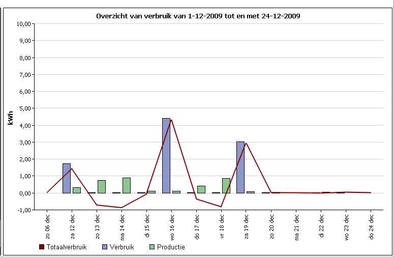

Re: Measuring Solar panels
And in the new version of Plugwise V20091218.0 you will see the incoming and outgoing energie.
Very nice and interessing.
Below a picture.
BR Wim
Below a picture.
BR Wim
- solarpanels_enrgy.jpg (35.53 KiB) Viewed 7974 times
