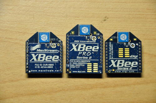

Below a picture of some 802.15.4- and Zigbee-modules i've experimented with:
