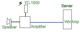

Fase 1 - The conception
Because I had no idea of the problems I will face I thought that starting small isn't a bad thing. The kitchen, situated at ground level will be the first room to fix. I had already a wired coming from the 1e floor to the kitchen. On the server end I made a 3.5mm jack plug and plugged that into the soundcard of the server. The sound coming from the soundcard isn't strong enough to get a descent volume so in the kitchen I placed a small amplifier with a bass speaker and two smaller speakers. A small speaker set used for the PC for only 16.95 euro. I added a 'KlikAan KlikUit' YC-1000 switch and a MS13a motion detector to complete the setup. After I made an event and a trigger in HomeSeer I was set. When I enter the kitchen the amplifier turns on, WinAmp start with an internet radio url and music is playing in the kitchen till the motion detector doesn't see motion for more then 10 minutes.

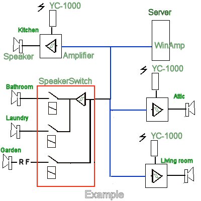

Fase 3 - Understanding the system
I had to find a way to distribute audio to the different rooms. To do this I came up with an SpeakerSwitch box. With a few relays and some other components is made a control to switch a stereo audio line on and off. Control is coming from the server via the printer port. I made a small application that can control the SpeakerSwitch and can be addressed by HomeSeer. I had 8 relays but 2 of them proved to be defect so I ended up with a 6 channel SpeakerSwitch. One audio channel in and 6 switchable audio outputs. So, back to the ceiling speakers. They need an amplified sound to be heard. Since I had 3 rooms with ceiling speakers I disconnected three channel in the SpeakerSwitch and I had to put an amplifier in between. I only need a small amplifier and making one would cost about 10,- euro of parts, work, time and there would be a change of failure. Back to the PC shop for another speaker set. This time a small 2 speaker set, 6 watt output and only 7,- euro. I ripped the print out of the speaker set, placed it in the SpeakerSwitch and connected the wires. Adding 3 extra MS13a motion detectors in the different rooms added also so much complexity that HomeSeer couldn't cope with it. I had to write a control script that handles the input and take the right actions by switching on the right channel(s) and if needed the amplifier in the kitchen. Four rooms done, more to come.
Fase 4 - Zen, and the art of bus addressing
Playing around with the audio system this far turned out to be fun and is adopted by my wife very quickly, she is pleased with it. I got permission (read: I was ordered) to do the other rooms also. With 4 out of the 6 channels already taken I had to make a choice with rooms to do. I had to pick two of these, the attic, the bedroom, the library, the living room and the basement. I didn't like the idea to pick just two, I wanted to have them all. So back to the design table again. Still remembering the wire from the server to the kitchen? That one is passing the living room too so I could split it there. Doing so I can turn on the amplifier in the living room and the kitchen separately while still using 1 channel... I took this idea further and extended that wire throughout the whole house. Just 3 wires (left, right and ground) from the attic to the basement. You just tap into it where you need it. The AudioBus was born and put in use. Now all are connected to the audio system. The ceiling speakers have an address of 1,2,4 on the SpeakerSwitch. (address 1,2,4,8,16 and 32). I gave the AudioBus the address 64 so the script will know that a YC-1000 switch need to be switched in this case. All rooms have audio now.

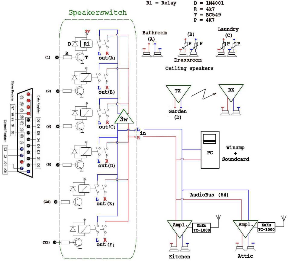

Can you give us more info about the home made SpeakerSwitch box (scheme) and the application?
I will make a full package including schematics,scripts and events and i will post it later.
Re: Audio for every room.
Here's the full schematic
Complete schema
Complete schema
I left out some rooms to simplify the drawing
The scripts make use of a configuration file called ZMC.ini. This is a part of the MediaCenter scripts that i am developing henche the strange name and setting in the ini

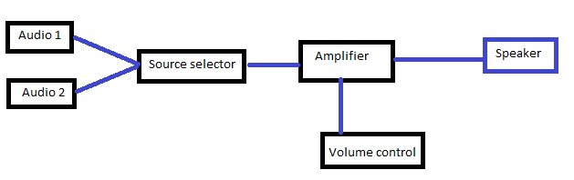

I've been using this audio system for more then a year now and i must say it's something that is gonna stay in the house. The WAF is fairly high so thumbs up for that. But as always you want more so i started working on version 2.0. This version need to fullfill the folowing requirements
- (Nearly) Every room audio
- Each room must have it's own volume control
- Must be able to pick more then one audio source
- The ability to call out announcements
- Motion detection and time based events controls which room will play audio
The rooms that are candidate are:
- Bathroom
- Kitchen *
- Livingroom *
- Master bedroom *
- Utility room
- Walk in closet
- Spare bedroom
- Attic *
Each room must have something like this.
The rooms don't need high quality audio so just one speaker will do expect for those with a * behind them. These room will have stereo. This requirement will up the scale considerabaly because now you need 12 amplifiers instead of 8 !
I've tested all the seperate parts of the chain already and now i am putting things together. When i have some picturse later on i will post them here.
