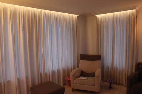

- behind all my curtains (12m)

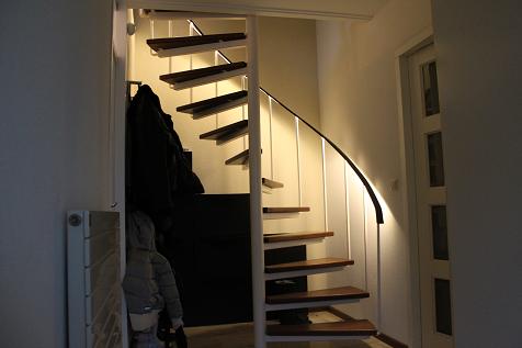

- under the (hand)rail of the staircase (5m)

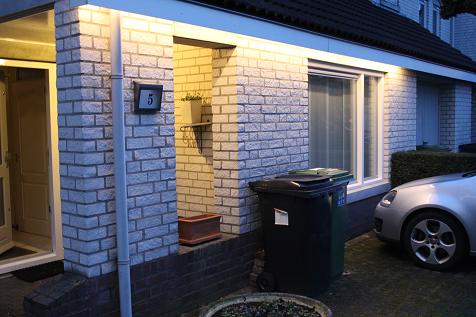

- in front of my house (6m)

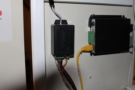

I control the LEDS with two Chromoflex RS232 controllers
So the LEDS are completely dimmable and can be controlled per curtain, staircase etc.
Nice thing about thew Chromoflex controller that the controller is initially for RGB, so if you use only white LED strips you can control 3 LED strips independent.
So if my curtains close the LED lights go on automatic, If I'm not at home at night only the LED light go on, saving energy and from the outside give a good at home impression :D
The power usage in DIM (mood) mode is just around the 2.5 watt. If you need some bright light then you can get a huge bundle of light by setting the controller to max.

On the images below the light looks somewhat bright, but in real it's a very cozy (mood) light.
The LEDS on the staircase have a very good function, I keep them on till late making it very easy and save going up and down the stairs.
Specially in very Dim position.
Looks blue but that is outside light :-)
Chromoflex RS232 LED Controller

The Chromoflex can be used even over a long distance.
I have wires in every corner where also my curtains start.
So I use a 4 wired cable which goes to the fusebox, over the same cable I can give power to all my electrical curtain rails, so 1 power supply from fuse-box closet.
The other two wires on the cable are connected to each LED strip.
1 Chromoflex is for controlling 3 Ledstrips on 3 different windows. The other Chromoflex is for controlling the staircase and the outside LED strip.
The strip in the bathroom is on 7 volts steady powersupply and switches on together with the main light of the bathroom.
The LEDS on full voltage generate a lot of light so normally the are on very low voltage, 11 meter in my livingroom (see pictures) are consuming only 2.5 watt :)
