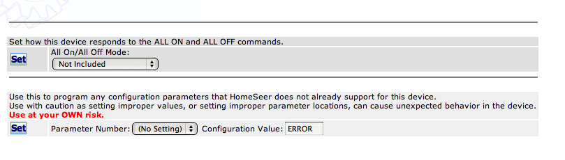

I have also some of this devices and have programmed them using Vera box.
You can also do that with Homeseer..but the support is very weak
Schermafbeelding 2010-07-18 om 14.34.30.png (35.65 KiB) Viewed 6391 times
