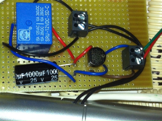

Thanks Henk_J, for your quick reply.
I've bought the components you mentioned and made a setup.
It works, but in my case only if I press the bell button for three seconds or more.
What could I be doing wrong?

Try to remove the condensator and see what happens. Did you connect the condensator correctly (plus to plus and minus to minus) ?

Hi Henk_J,
I'll try the setup without the condensator.
(I've checked: minus is connected to minus ans plus to plus).
I've made a (sort of) diagram of the way I've build it - see attachment.
I also posted a piture of the components used (and the amateuristic way I've made the setup
- foto of the setup

Relais is 12 V. I've noticed that the AC voltage especially when you press the button very short is not enough to activate the relais, that's the reason I used a 6V relais. Activation time is so short that this will not damage the relais.

Yep, that was the trick!Henk_J wrote:Relais is 12 V. I've noticed that the AC voltage especially when you press the button very short is not enough to activate the relais, that's the reason I used a 6V relais. Activation time is so short that this will not damage the relais.
I've replaced the 24v relais with a 6v relais and it now works great.
