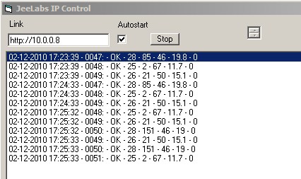

Translated data comming from the Jeelabs webserver
Data comming from the jeelabs webserver

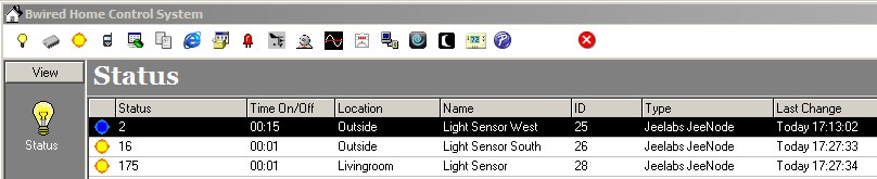

Roomboard data displayed in Bwired Home control system
Roomnode data displayed in Bwired Home control system

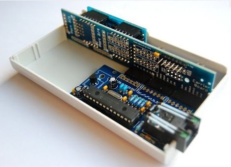

The Webserver is a Jeelabs Ethercard, Carrierboard and a Jeenode.
Webserver ethercard
Webserver ethercard
