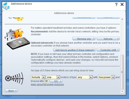

Hi Frank.
It's from Vera 1, but it should be the same.
Push "Dashboard" in upper right corner.
Push Add/Remove Devices (the +! button see screen dump.)
Find Z-wave and push next.
Scroll down. At the bottom you will find controllers. (The above screen dump)
Regards
Morten

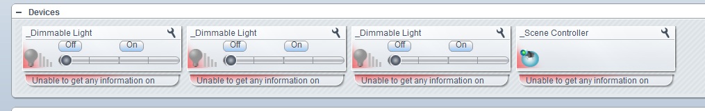

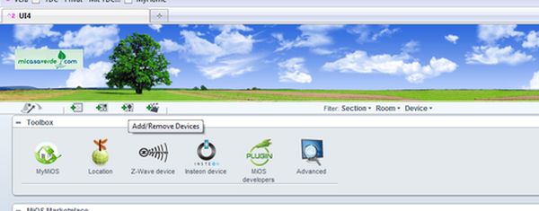

Hi Guys,
Thanks a lot, I totally missed that little button
Now HS and Vera2 see each other, but it does not work yet.
I configured HS as primary and Vera2 as secondary, in HS the devices work.
Vera2 received 3 devices and a scene controller, but after that they cannot communicate with each other, see screendump.
