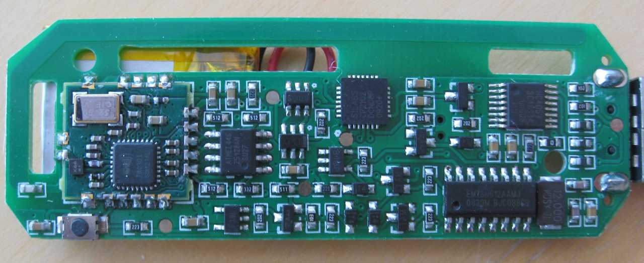

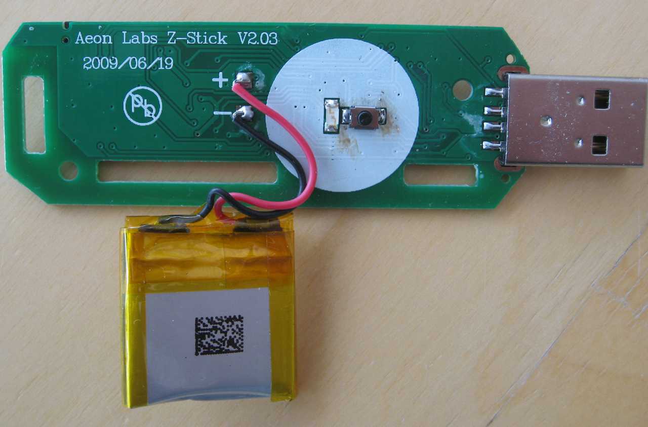

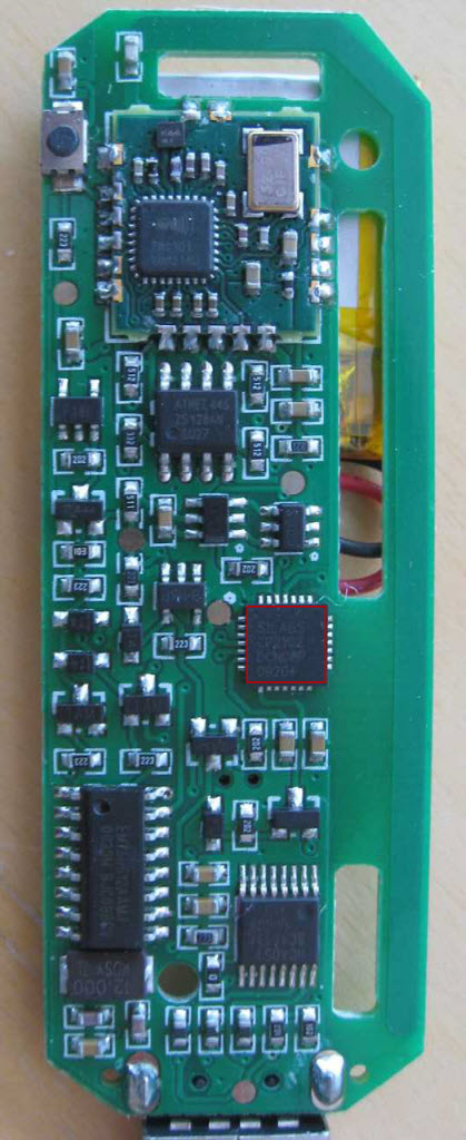

I have pictures of a Z-Stick.
This is the quality the forum allowed me. If you need better quality, we must find a way to give you the originals.
Regards
Morten
Mdamen
Posts: 390
Re: Aeon Labs controle module via RS32 possible
Post by Mdamen »
Thanks for the pictures.
Here's is my analysis:
There's a UART to USB chip located here:

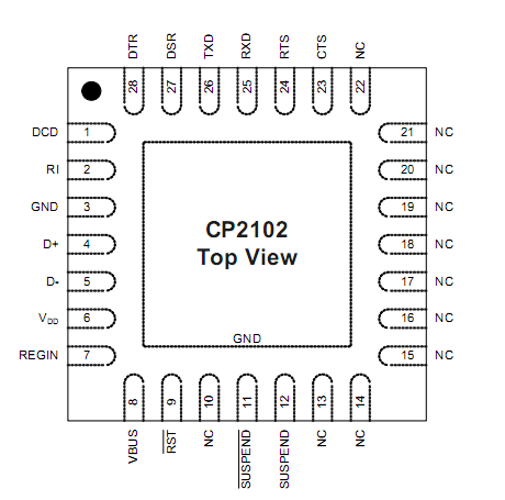

And here is a piece of info out the datasheet:
As you can see these upper pins are serial data lines (RXD, TXD) and that would allow to hook the aeon labs stick up to a serial port.
This does require a steady hand though :-) Please note that you also need some power supply (5v) to replace the USB power supply.
All and all a bit of hacking, but it is do-able.
The full datasheet of the UART to USB chip is located here:
silabs.com/Support%20Documents/Technica ... cp2102.pdf
