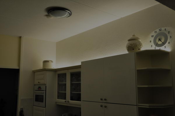

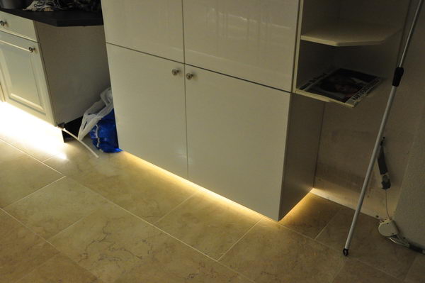

You mean something like this?
Here I didn't have to use a plastic cover to make the light more diffuse:
But here I did:
It's a matter of distance and the surface on which the light is shining.
You can always apply the aluminum strip with diffuser afterwards, if the result is not satisfactory; or try a small length before you decide what to do.

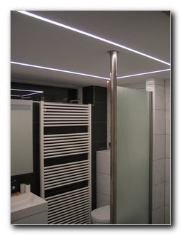

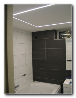

I have Ledstrip embedded in a plastered ceiling which is done with Alu U-shaped strip that comes with a diffusion cover.
I did that in the bathroom as shown here:
As you can see this works out pretty well, I think the type of solution you are looking for is gonna require a similar solution.
Regards, Maarten.

looks great,
when we we give our bathroom a make over in the future,is this a good idea.
