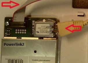

You all know that I recently bought a Visonic Powerlink2 with the reason to conect it to my domoticasystem.
You can see the earlier postings about it here
http://www.domoticaforum.eu/viewtopic.php?f=22&t=5624
Powerlink2
Powerlink2
Together with Digit (he did most of the work) we mananged to find a way to control the basic Powermax Pro functions via the Powerlink 2
Functions Like Arm Home-Away and Disarm bij sending a HTTP request the Powerlink.

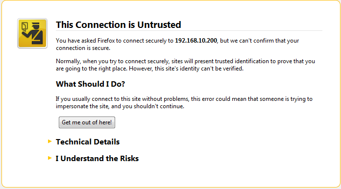

Good to hear! Although I am still struggling with mine to get it up and running.
I do not find it that strange the password is not encrypted. All that basic authentication, typically used to exchange userid and password, does is obviscating the password using base64 encoding which is easily reversable. A problem although is that you can use HTTP instead of HTTPS to access the web interface. Is it possible at all to use HTTPS?

Re: Visonic Powerlink2 Hacked
Are you able to access the interface using HTTPS or only plain HTTP?
Yes, you can: :lol: (I'm serious)
