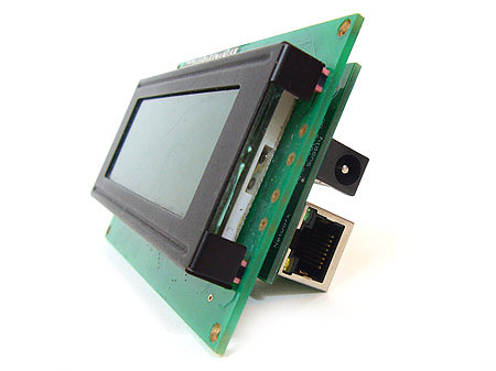

I ordered a Twatch Networked LCD.
The #twatch connects to Twitter and scrolls the latest trending topics and related tweets.
It can also display PC system stats from programs like LCD Smartie (and perhaps Homeseer).
The Twatch is constructed from files and firmware by DangerousPrototypes.com.

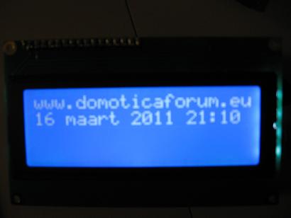

Twatch network LCD in progress
Post by Verkenner »

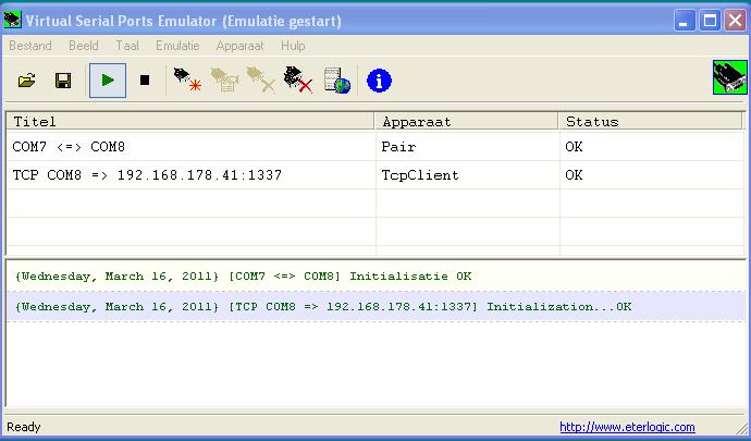

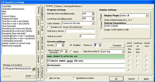

Connect the Twatch with a straight network cable.
When booting the Twatch gets the IP from the Router (DHCP).
This IP-address appears on the display. Now you can PING to the Twatch.
Download the free Virtual Serial Port Emulator on http://www.eterlogic.com/Downloads.html
Download LCDsmartie on http://lcdsmartie.sourceforge.net/smartied.htm
Install both programs VSPE and LCDsmartie.
Program VSPE redirects the serial LCD-smartie-output to the network LCD-backpack.
First step is making in VSPE a serial connection between free COMM ports. e.g. COM7 and COM8 (virtual serial port pair).
Second step is to create in VSPE a TCP-client to connect the serial port to the Twatch TCP-server (port 1337, no flowcontrol)
Third step is connecting the TCP-client to COM8 (115200,8/N/1).

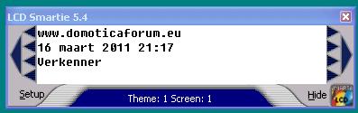

Four: Choose matrix.dll (Orbital code) in the display settings of LCDsmartie.
Five: The Startupparameters in LCDsmartie are COM7,115200
Six: restart LCDsmartie

Proggie LCDsmartie
Proggie LCDsmartie

Sorry, the picture is not sharp  ;-)

Re: Twatch network LCD
Nice! Looks easy to setup.
1 question; why doesn't line 3 of the display show your username?

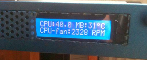

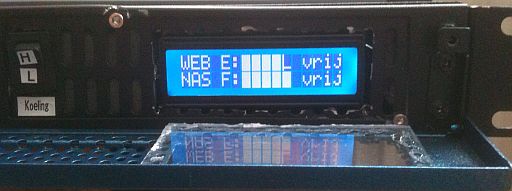

I've also got an LCDsmartie in my homeserver. great for monitoring free HDD space on the NAS disks, and motherboard status warnings.
I didn't connect homeseer status to it because I've hide the server in a closet. But mayby it's possible with a RSS or webscripts..
here some previews of my display @ 1U backbone server holding.

@ nightcrawler -> nice job and is the background LED always on?
__________________
nightcrawler
Posts: 18
Joined: Sun Sep 05, 2010 9:28 am
Location: Apeldoorn
Post by nightcrawler »
djdive wrote:@ nightcrawler -> nice job and is the background LED always on?
No it's auto switching on and off with use of a string command in LCD-smartie. If windows send a "screensaver" signal then the LCD leds are turned off.
When there is an activity with mouse of key press the background turns on.
