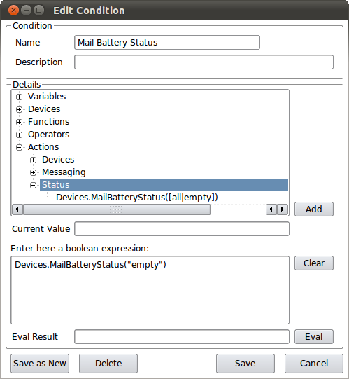

Ok, removed the code.
You can now use an condition action for this, and select type of report.
Just create an event with a time trigger when to report and attach a condition like the example in the screenshot below.
More build-in condition actions like this will follow soon...

I updated to version 0.1.197 but can't see the "Status" option under "Action" in the condition window.
Regards
RDNZL
Posts: 1008
Re: Battery status e-mail
Post by RDNZL »
Not all code changes are reflected in the binarie files on svn.
(DomotiGa.gambas and DomotiGaServer.gambas)
You can recompile them yourself when you load the project in Gambas IDE.
I have updated the binaries now, so you can just download and run them.
Regards, Ron.
