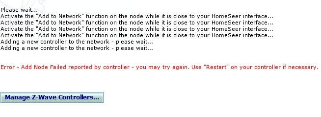

I have a DUCO system in my house, CO2 RH and IQ.
If i want to include the C02 unit homeseer respons but can't complete the include function. Maybe homeseer doesn't support the device?
See the attachment
See the attachment
- error message
