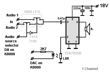

This schematic is just 1 channel. The volume is controled by a selfmade analog opto-coupler http://members.home.nl/b.vanzoelen/2011.htm#10. The complete system have 12 channel like these and another 12 without an amplifier. I just needed the first 12 and those used up all my DAC ports to control the volume. However the board have another 8 I/O ports left with is use to control the other 12 channels that are not amplified. They are very suitable to connect to another media center, amplifiers or any other device that just need line level input. At the moment i have no need for them so i consider as them a nice bonus for now.

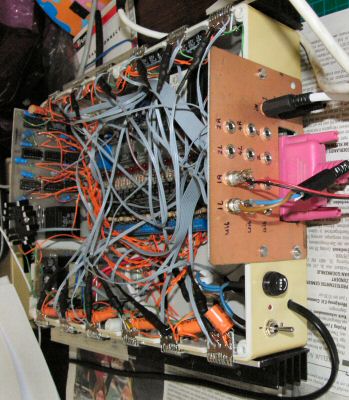

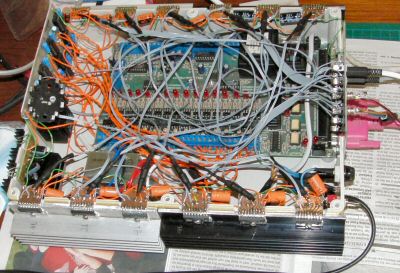

Here are a few images of the complete system still on the test bench.

Is it possible to have a look at the complete scheme?
Patrick
Re: ZMC v2.0
Actually that's the complete schema. It's just multiplied for each extra channel you need. The I/O control board i use is an old Velleman K8000 but that one need to be connected to the parallel port. You can better use the more modern K8054 (or K8051 i forgot the number) That one uses USB and there is also a plugin available for it. But nothing is stopping you to use an Arduino for it.
