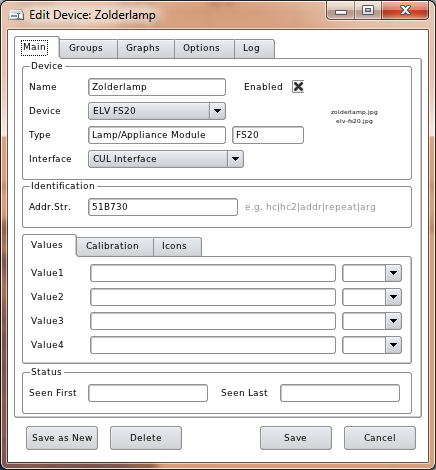

I tried to add a lamp, but it came back with an interface error. Probably stating it can't find the CUL device?
2011/08/29 09:05:34 [Devices] Interface for device with name 'Zolderlamp' is '32'
2011/08/29 09:05:34 [Devices] Address for device with name 'Zolderlamp' is '51B730'
2011/08/29 09:05:34 [Devices] Unknown Interface 32 for device 'Zolderlamp'!
I've added an attachment with my added device in the overview.

The odd part, just continueing my testing....
when I switch the light manually, it does see it properly in the logfiles:
2011/08/29 09:09:03 [CUL] FS20 message received with address: 51B730 (221234241411) command: Dim 9
2011/08/29 09:09:03 [Devices] Interface with name 'CUL Interface' has id '32'
2011/08/29 09:09:03 [Devices] Device with address '51B730' is 'Zolderlamp'
2011/08/29 09:09:03 [Devices] Device with address '51B730' and 'Zolderlamp' is a new device
2011/08/29 09:09:03 [Devices] ValueUpdate() called for device with id '39' and name 'Zolderlamp'
2011/08/29 09:09:03 [Devices] Device change triggered for device with id '39' and value1 'Dim 9'
2011/08/29 09:09:05 [CUL] < F51B73000E3
2011/08/29 09:09:05 [CUL] FS20 message received with address: 51B730 (221234241411) command: Off
2011/08/29 09:09:05 [Devices] Interface with name 'CUL Interface' has id '32'
2011/08/29 09:09:05 [Devices] Device with address '51B730' is 'Zolderlamp'
2011/08/29 09:09:05 [Devices] ValueUpdate() called for device with id '39' and name 'Zolderlamp'
2011/08/29 09:09:05 [Devices] Device change triggered for device with id '39' and value1 'Off'
2011/08/29 09:09:06 [CUL] < F51B73011E2
2011/08/29 09:09:06 [CUL] FS20 message received with address: 51B730 (221234241411) command: Dim 9
2011/08/29 09:09:06 [Devices] Interface with name 'CUL Interface' has id '32'
2011/08/29 09:09:06 [Devices] Device with address '51B730' is 'Zolderlamp'
2011/08/29 09:09:06 [Devices] ValueUpdate() called for device with id '39' and name 'Zolderlamp'
2011/08/29 09:09:06 [Devices] Device change triggered for device with id '39' and value1 'Dim 9'
Trying to recreate the lamp device, or trying to switch it after having it manually switched doesn't make it work. I still get the same interface 32 error.
