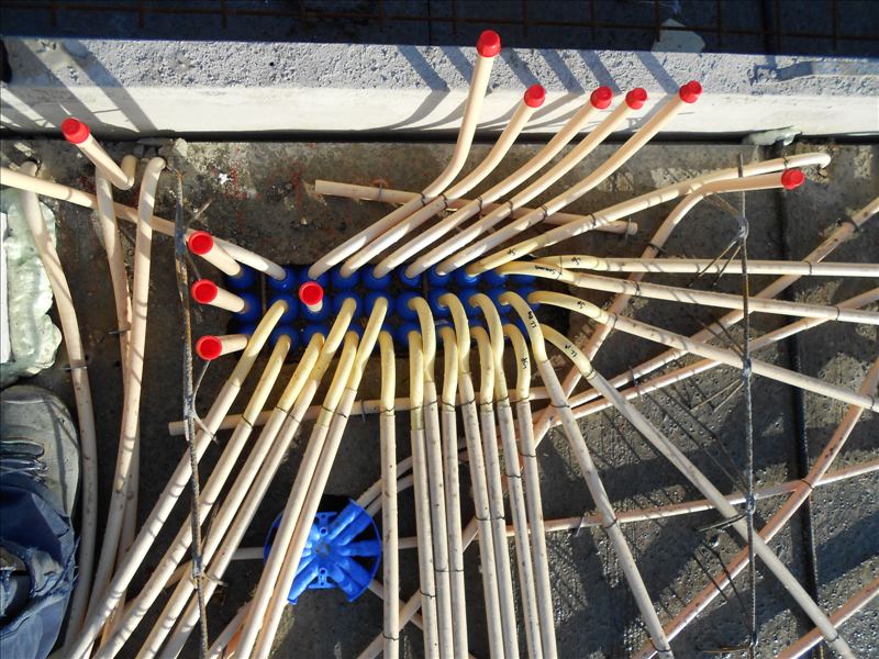

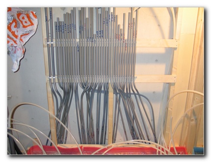

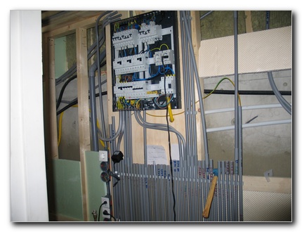

This is what happens when you let a forum influence decisions concenring the building of your new house :D
Meterkast binnen (alles >= 220V)
Meterkast van boven
Meterkast van boven
AV-kast van boven (sensoren en av/ict)
Met de hartelijke dank aan de e-installateur die afgelopen vrijdag, net voor het volstorten van de 1e verdiepingsvloer, deze foto's nog voor mij heeft genomen.

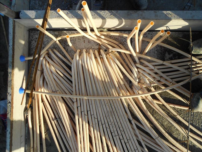

Your not the only one, this was the part I put in the base of of our houseboat:
the basics
the basics
this is how that continued into becoming a Technical room:
and starting to get things working
and now it not a pretty sight any more, so sorry no pict yet, maybe when I cleaned it a bit....
Regards, Maarten.

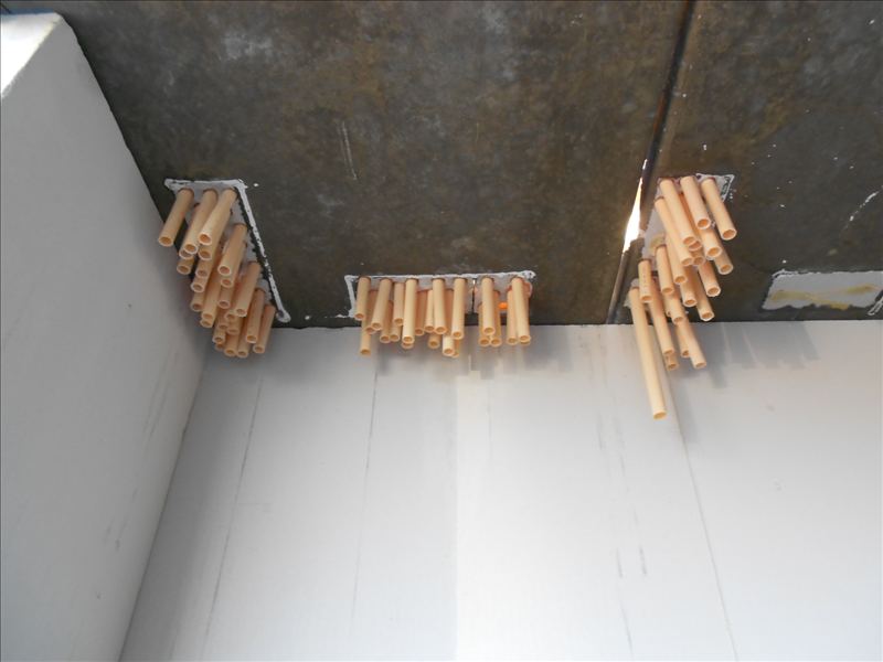

I am redesigning my house.
Everything is open like ceilings and walls. Everywhere where possible, there will be ethernet and spare tubes.
This was the chance to make everything ready.
Not that much like the above pictures :mrgreen:
But a new house would look like this too!
