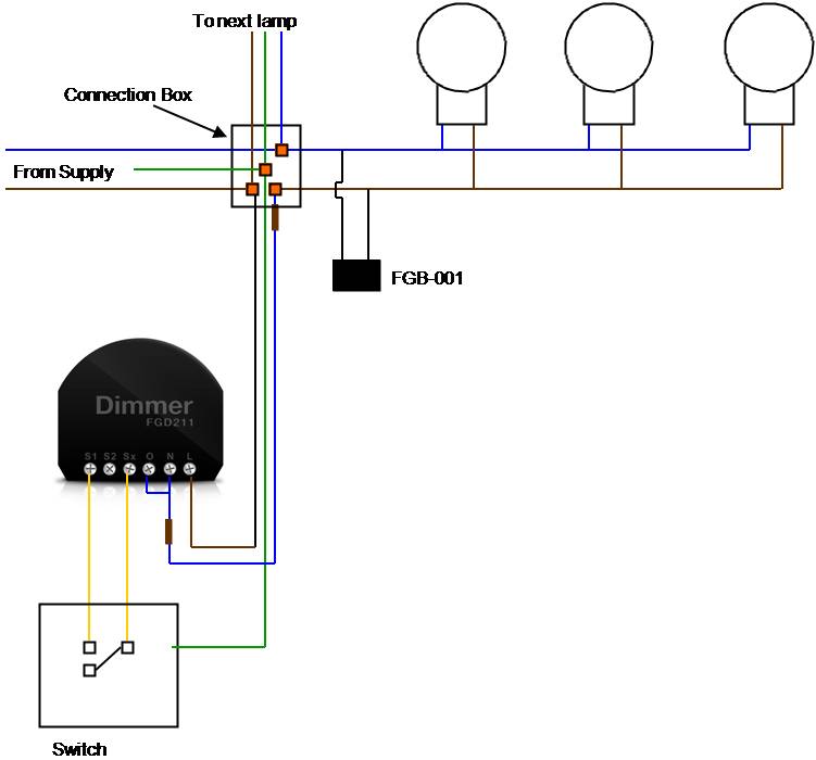

I also had to ask this question a while ago, just to be sure.
It is connected in parallel with the load, or at least that's how I connected it following advice from this forum and it seems to be working fine.
I have attached a diagram showing how mine is connected to 3 LED lamps.
NOTE: the diagram depicts a standard UK lighting circuit setup, so this may not be the same as yours.
Paul..
Paul..

The LED's I am using on this circuit are 5 watt each, so 15 watts total. They are not the dimmable type so I have the Fibaro configured as on / off only. I installed the FGB-001 to prevent flickering of the lamps when off.What is the power consumption of the leds in total. I also want to install the Fibaro with 3 leds, 3 watt each, so in total 9 watt. I wonder if the Fibaro has any problem with dimming this low consumption (the led's are dimmable ofcourse).

I tried it as above but I got still flickering and a lot of hum.
I have 9 Luxor 1 LEDspots from 2,5 watts so totaly 22,5W.
the 2 transformers I use are dimmable (fase cutting) .
i made it back as it was before.
for that I use a zwave switch(DUWI) where I made the relais inside passive on the switch side(I cut the fase on the board) ,and behind that a small KAKU Dimmer module. they are cheap and they work great to dim LED´s
I use the KAKU remote to fix a level that I like and switch on and off with zwave.
it is not the best solution but it works for me.
if someone know a differend transformer that works with a zwave dimmer then please let me know.
