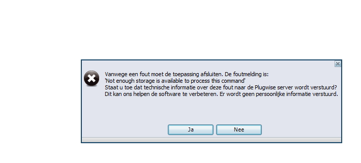

Within source 2.21 i receive the below storage error
"Not enough storage is available to process command?"
I have enough storage and memory?
Im running the Plugwise source on Windows 2008 server R2 SP1 (standard latest version)
This occurs 1 or 2 hours after starting the source, so not direct, still then enough resources available.
it looks like an OS thing, but it only happens on plugwise....
Who can help?
plugwise error
plugwise error

No strange things in the "event log/viewer" of w2k8 (on the date/time that the error comes up)?
Re: Not enough storage is available to process command?
No nothing to see?
I searched on google and found a lot about the IRPStackSize
but all these changes i did, does not help regarding above problem
strange is also that it only happens if i open up plugwise source, when i keep it running minimzed, no problems?
solutions is now to not open it up :D

Unbelievable i found the solution on this forum and also in a bwired topic :D
The topic was not related to this problem but it solved my problem anyway!
After setting the settings.ini to the used Comport for the source software and adjusting the shortcut to that comport, no more memory problems??
check http://www.domoticaforum.eu/viewtopic.p ... 350#p42426
So this is a strange bug in the Plugwise source software!
