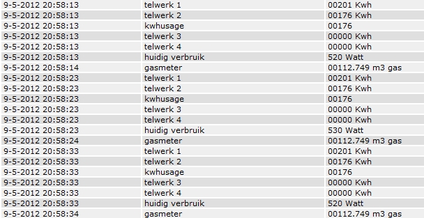

And are you also receiving decimals like 123.45 kWh instead of 123 (rounded), like i still see on some of the images in this topic?

Re: Reading the P1 port of a NTA8130 Dutch Smart Meter
Post by pjanssen »
@Bwired
Currenly the meter readout i have only give 00123.000 on all 4 meters (so there always end on 000). The gas meter gives 3 numbers behind the comma but only updates once every hour (and skips them frequently). The current usage is accurate on 0.01 kWh. Thats all there is. I think they can still improve a lot. Not sure if they will do that.

Re: Reading the Kamstrup, type 162 NTA en 328 J NTA form Enexis
Post by pjanssen »
I just talked with my father about it. He was quite sure that there was no data on our IR port.
The decimals are listed in the P1 output but are always 000.

Are you sure, because opening up the IR port probably needs to be done with sending a command via the IR port. But could be not the case with kamstrup.
Not getting any decimals really sucks, i have the same now on my Ace3000.
