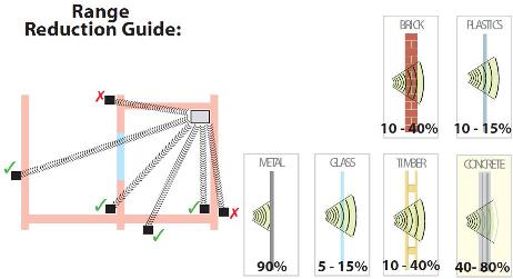

If the button is not received close to the receiver contact support to see if the button can be analyzed.
The number and type of walls in between have impact.
