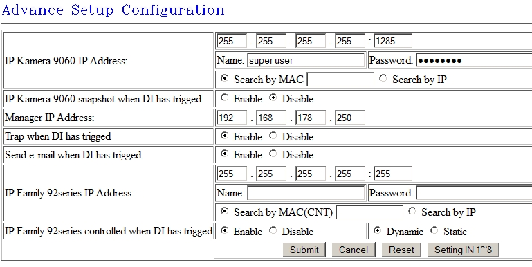

I realize I'm only a beginner with this Plugin, but I've been busy experimenting with it over the weekend. So I hope this question is less embarrassing than my earlier question on the Plugin.
Problem
Homeseer Pro crashes as soon as the IPPower 9212 sends a SMTP Trap. I can reproduce the problem time after time.
I've read all the messages in the forum on the IPPowerPlugin, but as far as I understand it, version 0.5 should have fixed this problem?
I'm stumped...
Thanks in advance for any help.
Olof
My versions:
IPPower 9212 firmware ("Release Version"): V2.05 2010/12/13
IPPower Plugin: 0.0.0.5
Homeseer: Professional Edition 2.5.0.20
Error message from Homeseer after it crashes:
IPPower adv setup.jpg (182.38 KiB) Viewed 13331 times
Re: SMTP Trap causes HS crash (plugin version 0.5)
This is a known problem with the Pro version of Homeseer only (there is some information in another topic). While I do not have Homeseer Pro I was not able to reproduce this problem. Currently I do not have a working IPPower anymore, so support for the plugin is very limited.
