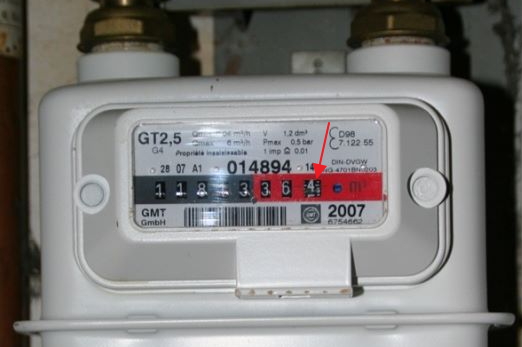

I have been working on the installation of the CNY70 on my gasmeter which has a reflective surface on the zero (not the six digit)
The link is made to one digital entry (impuls counter) of an IPX800 v3.
Everything works fine when i pass a small aluminium sheet under the CNY70 . The counter works.
When i put the CNY70 in front of the last digit , nothing works.
I have been playing with all possble positions of the sensor ( distance, orientation .....) and I am now wondering why is does not work.
My IPX800 v3 delivers 3.3V and NOT 5V . Could that be a reason for the lack of sensibility of the CNY70 ?

Post a pic of your gasmeter and I'll tell you a if it's possible to use a much more reliable way to count the pulses

Here is a photo of the gas meter. The inside of the zero is reflective ( wheel at the very right)

The only thing i can think of is that the CNY is working a to low voltage for the small mirror in the 0?

Light emitting diodes (which is inside the CNY70) emit light as a function of current, not voltage. Typically, these need around 20 mA.
The voltage drop across a LED is typically 0,6V depending on colar.
The datasheet for the CNY70 (http://www.google.nl/url?sa=t&rct=j&q=& ... Je1vnQ23GQ) mentions a drop of 1,25-1,6 V with an If of 50 mA.
Let's say drop = 1,2 V, If is 20 mA.
You have 3,3 V supply voltage, less 1,2 gives 2,1 V across the resistor. V=I*R --> R = V/I --> R = 2,1/0,02 = 105 ohm. Makes sense, the have a little more than double now (220) with a little more than halve the "normal" (5V) supply voltage. I'd change the resistor, no need for amplification circuits.
The datsheet also shows some diagrams relating to voltage, current and reflective surface distance.
Good luck!
