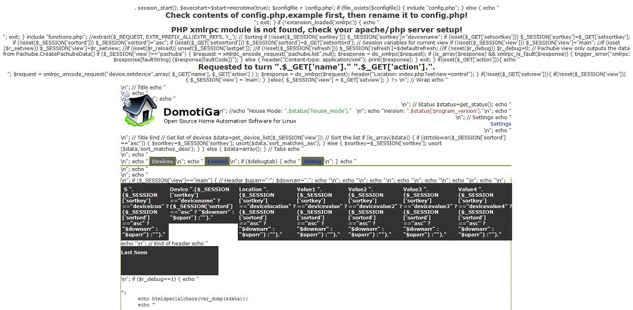

thanks now is my server running i can connect it by an other pc. but the page looks strange.
i have done all things from the domotiga website for clients again and stil it looks strange.
i have uploaded an screenshot from the page maby somebody can help me
wwolkers
Posts: 273
Re: Cant get webserver runnig
Post by wwolkers »
did you copy the config.php.example to config.php and edit it?
Also, you seem to be missing the php5-xmlrpc package.
'sudo apt-get install php5-xmlrpc' should fix that.

on which loaction? i have change the config.php at /var/www/domotiga
not the one on ~/domotiga/webclients/domotiga
if i sudo apt-get install php5-xmlrpc do than it says: php5-xmlrpc is already the newest version
Bob1208
Posts: 7
Joined: Wed Oct 31, 2012 9:51 pm
Post by Bob1208 »
i have change the config.php on /var/www/domotiga i dont have change the ~/domotiga/webclients/domotiga config.php.exemple file.
i have set mij docs into the domotiga server webclient to /var/www not to default ~/domotiga/www
and i have enable webclient in domotiga sever.
i have enamble the xml-rpc in domotiga server
when i do: sudo apt-get install php5-xmlrpc i get package allready installed and up to date
so i dont have installed apache2 php5 libapache2-mod-php5 php5-xmlrpc by my self (it was allready in the image) is there an way i can test of everything is correctly installed?

Ok, looks like your apache is not parsing the PHP files, now that I look at it again :)
It's acting as if the index.php file is just a plain html file (you don't have an index.htm or index.html in your /var/www/domotiga, do you?)
check if the php5 module is already enabled:
'sudo a2enmod php5'
if it wasn't configured already, you have to restart the apache2 service after that:
'sudo service apache2 restart'
If it was already enabled, you are probably missing the handler for .php files in the config somewhere.
That setting should be in /etc/apache2/mods-available/php5.conf
That file should contain something like this:
<FilesMatch ".+\.ph(p[345]?|t|tml)$">
    SetHandler application/x-httpd-php
</FilesMatch>
(and more btw)

no i dont have an index.htm or index.html file in my /var/www/domotiga is this right?
by sudo a2enmod php5 i get an error: module php5 does not exist.
now i do sudo apt-get install php5 and is says unable to locate package php5
wwolkers
Posts: 273
Post by wwolkers »
correct, you should NOT have index.html or index.htm.
It looks like you forgot the 'sudo apt-get install apache2 php5 libapache2-mod-php5 php5-xmlrpc' or it didn't run correctly. You should have a php5 module for apache (libapache2-mod-php5 package)
Did you follow the apache install from http://www.domotiga.nl/projects/domotig ... l_Optional ?
