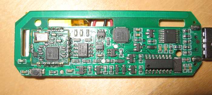

I am a nerd, hence i had to see, how it looked inside a couple of years ago. :-)
Regards
Morten

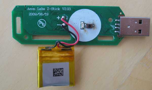

@morten Great, what's the yellow thing. Did you attach it or is it also inside the stick? :)

mrqnapper wrote:@morten Great, what's the yellow thing. Did you attach it or is it also inside the stick? :)
Battery. The stick is also usable when it's not plugged into the USB port.

Yes a battery, and it is right at the opposite side of the Z-Wave module. Hence I don't think the led/button side of the stick is the good side. :-|

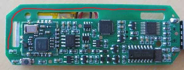

According to me and as far as i can see it on your image the red line is the antenna

You are right, I think.
Over exposed image. :-)
