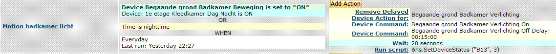

Re: bathroom light / fan control ms13-fibaro
If a MS13 is involved then this is how usualy configure it.
Please note that i use the day/night sensor of a different MS13. That sensor is the MS13 that is closest to my RFXCom antenna. If it's dark at that location then it's dark enough in every other room too. :)
mrqnapper
Posts: 234
Post by mrqnapper »
This is how I have it for now. Why is the 20 seconds waiting time?
badezimmer.tiff
badezimmer.tiff (50.94 KiB) Viewed 7773 times
Your image isn't shown
The 20 sec. delay is just a value i picked.
If the MS13 goes ON then by default it will send and OFF 1 minute after the last ON
The event is set that it can not retrigger within 30 seconds
The event need a reset of the timer within 15 minutes to keep the light ON.
I want to prevent that the server is getting very busy with just this event.
Based on this i thought 20 seconds is a good value :-)
