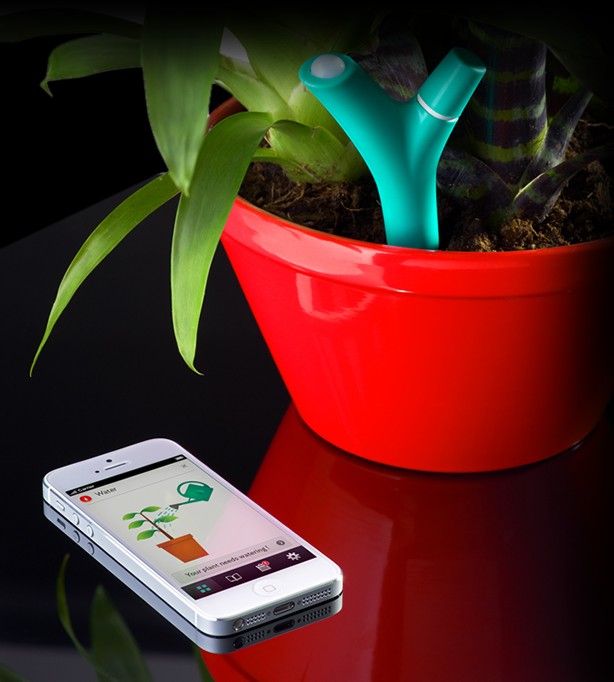

Parrot Flower Power plant sensor
plant sensor
Wireless sensor
measures sunlight,
soil moisture,
temperature
and fertilizer
Not much extra info yet, looks only bluetooth (parrot of course :-))
of course with Apple App
Could be interesting!

Re: Parrot Flower Power plant sensor
Post by jeroen_ »
That looks cool indeed, and definitely one of the 'want to have' kind of sensors. Bluetooth means more noise on the 2.4Ghz band though, then again wifi is on 5Ghz for some time already anyway.
For power consumption reduction they appear to use the new Bluetooth 4.0 BLE, they state "Bluetooth Smart Ready Smartphones", thus that is likely it.
And of course for "our" purposes we rather see those things talk to a central box, which should not be too tricky given the right bluetooth stick ;)
Lets see when the thing comes out, how much it costs and how compatible it becomes, should not take too long, it is not like bluetooth is a secret protocol ;)

As I had both the Parrot and the el-cheapo ones for a while now, but holidays and not being here to actually play/look at them kept me from actually 'reviewing them', here is a little summary:
Parrot:
+ measures: water level, fertiliser, temperature, sunlight
+ add water and the sensor directly notices this and informs the base, hence sensors in the toys work pretty good
+ In-app database is very extensive (probably the best thing about the app actually)
- The app requires a connection to the Parrot "cloud" to calculate your data - requires internet connectivity (turn it off in your celldata, it does not need to talk to them everywhere you go etc)
+ Can avoid the cloud with for instance: https://github.com/sandeepmistry/node-flower-power
and thus just read it from your Linux box etc. This does mean you don't get to use the nice App though and thus the DB.
(I still have to integrate that into my monitoring system)
- BlueTooth LE (Low Energy) which is not 'real' bluetooth, and is quite short range; hence have to be close to it (~4 meters) to be able to get the readings onto your iThing (or Linux box with BLE)
- with app: need to look at app once in a while or allow it to notify you (and thus suck up battery, and have bluetooth turned on, which I refuse due to security issues with that, hence turning it on once in a while, and thus forgetting about the app)
+ without app, thus using node-flower-power + integration in your system: pretty great as then you get central notifications, no need to turn on bluetooth on your iThing etc.
? I did not test it outside, thus no idea if it would survive snow; I can easily believe it survives rain though.
+ due to Bluetooth LE near unlimited sensors as the address space is very big (only tested one though, will likely get a few more later though)

From putting both devices next to each other the measurements where mostly the same (very small differences). Of course the El-cheapo does not see fertiliser.
The Parrot is effectively also a good UV/sunlight sensor (unlike the Oregons which report little variations), which is a nice thing, as in combo with the node-flower-power you can use this to trigger your lights on/off ;)
Hence, the combination of them is pretty good: you apply the Parrot to a plant for a while to see what makes the plant happy, add an el-cheapo monitor too to compare the results; when you know the water levels that that plant likes and the amount of sunlight etc.
Lady-happyness-factor with these toys: high.
Which is a good thing too ;)
