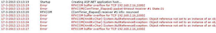

This morning I have install some new windows xp updates. After the install I let do a new startup of the windows xp and the Homeseer software.
But I got an error in the connection with RFXcom. See picture below.
I have restart the computer and Windows a second time, but there is no different in the error.
Do someone knows what there is wrong?
Can someone say how I can solve this?
B.R. Wim

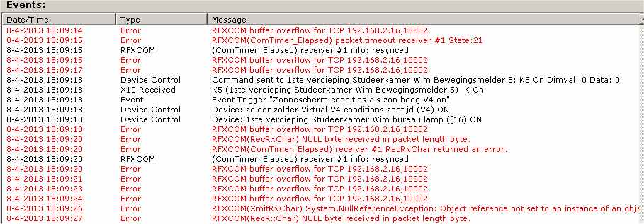

After a new update I got the same problem with RFXcom in Homeseer as last month.
Can someone say what is going wrong in my system or in Homeseer? Below a file of the copy of the errors.
But now the advice to disconnect the the RFXcom don't work anymore.
I use windows xp and Homeseer version 2.5.0.52 and in homeseer the plugin of RFXcom version 14.0.0.62
B.R.Wim

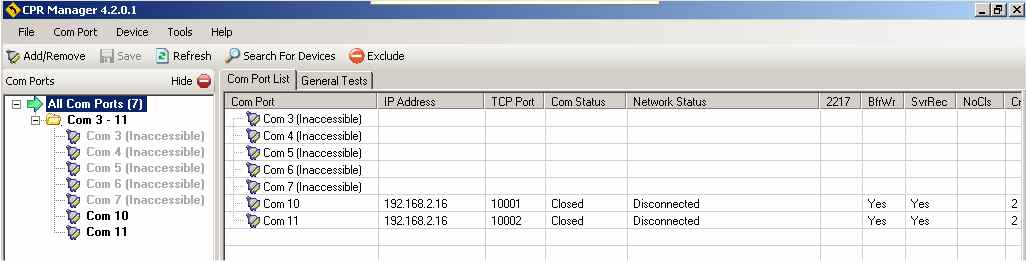

The receiver is on port 10001 and the transmitter on port 10002.
have you configured the ports correct?
Wim2008
Posts: 718
Re: Error after new start
Post by Wim2008 »
I think so. See the file below. I have made a copy with the CPR Manager.
You will see that the com ports 10 and 11 are connected with the receiver and the transmitter.
Isn't it so?
B.R. Wim

Akatar
Posts: 1135
Location: the netherlands
Post by Akatar »
why use cpr com manager?
b_weijenberg
Posts: 1746
Post by b_weijenberg »
Don't use COM ports but assign the IP address in the RFXCOM plug-in.
remove CPR from the system!
Wim2008
Posts: 718
Post by Wim2008 »
And where can I find how to do that?
B.R. Wim
