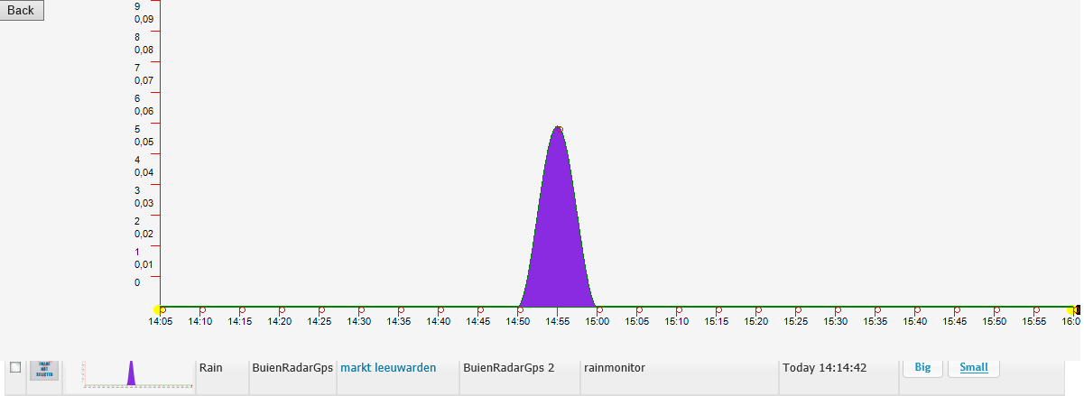

update buienradar monitor hs3 plugin
download zip file , copy the HSPI_BUIENRADARGPS.exe and HSPI_BUIENRADARGPS.exe.config file to the homeseer root directory, copy the SplineFormCpp2.dll file in the bin dir to the hs3 bin dir, copy the js files to html/js/buienradargps dir of hs3, copy the BuienRadarGps dir to the html/images dir of hs3
change:
devicestatus of io device is correct
graph is visible now in devicestatus column of the location device and can be made big or small by the devicebuttons. solitary graph page is not supported anymore
delete all the old buienradar gps devices.
change:
- buienradar1.0.0.5.zip
- (79.05 KiB) Downloaded 780 times
- example big graph
- buienradargpsbig.PNG (18.84 KiB) Viewed 27859 times
- example with rain
- buienradarhsp2.PNG (4.02 KiB) Viewed 27866 times
- which request ?
- buienradargps.PNG (10.58 KiB) Viewed 27882 times
