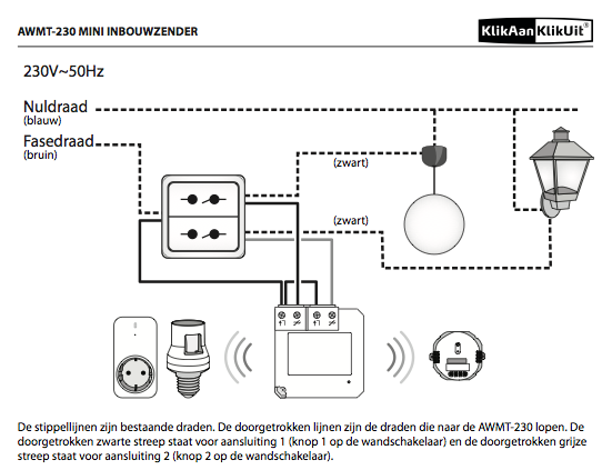

The switches from KAKU looks a lot like the Jung CD-500, but with a slightly bigger frame than the Jung.
the modules were Henk was referring to, also work with a double wall switch.
Take a look at the AWMT-230 klikaanklikuit.nl/shop/producten-1/zend ... -awmt-231/.

This would probably have been a good alternative. I have now combined the AWST 8802 with Berker IP44. This looks ok and should be sufficient.
I am still not sure how I would have combined this with the switches in the hall, upstairs and in the attic. This would put 3 lights over 2 switches in the picture, which makes it a bit more complicated. Unless you can just connect the wire from the switch to the neutral directly to switch a light.
