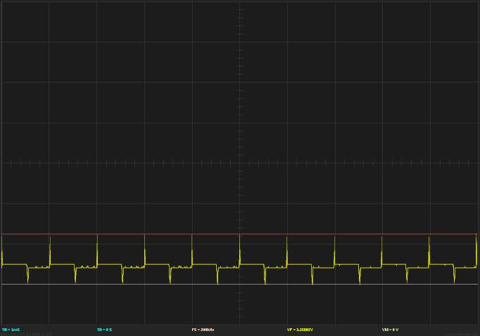

diagnostic test #4 yields:

OK1A high-to-low: 8us
OK1A low-to-high: 28us
OK1B high-to-low: 9us
OK1B low-to-high: 3us
The voltages are:
R2 + R3 against GND1(red line is 1.54 V)

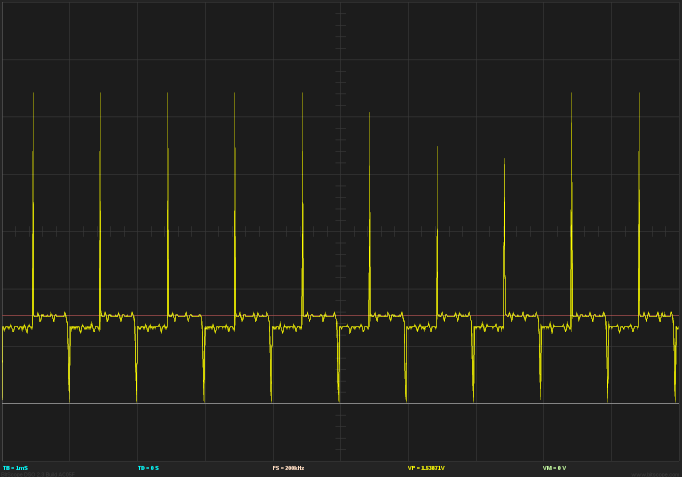

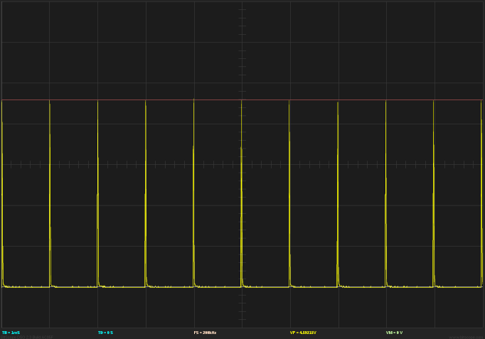

OK pin 5 against GND (red line is 4.59 V)

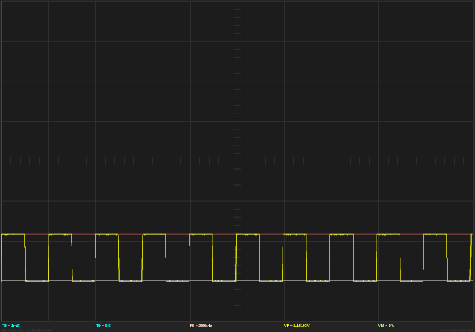

OK pin 3 against GND1 (red line is 1.25 V)

Time base is 1 millisecond.
Thanks,
Marc

I guess the traces were all made at different times, but it seems like they all cover an opentherm message being sent from the gateway to the boiler, nothing from the boiler. At least the OC_1 trace is clearly a transmission by the gateway. That looks good.
R2_R3 mostly stays below 1.54, which corresponds to 4.8mA - a bit on the low side (should be 5-9 mA). But that's not a problem for the gateway circuitry. In any case it's not enough to get the phototransistor of OK1B conducting. The spikes are probably the result of the voltage (driven by the gateway) changing between 6 and 16V. The boiler circuitry takes a bit of time to adjust.
OC_3 shows that during the upward spikes, the voltage on OK pin 3 reaches the level required to light up the LED in OK1B (around 1.2V). So the OK1B phototransistor conducts very briefly, resulting in the spikes seen in the OC_5 trace. These spikes will be ignored by the firmware of the gateway.
During opentherm messages from the boiler you should see voltages above 3.8V on R2+R3 for around 0.5 or 1 ms. If you don't get that, it means the boiler is not sending any opentherm messages. One reason may be that it doesn't understand the messages from the gateway.
The test #4 results show that the boiler interface of the gateway is working, although there is some difference between the rise and fall delays of OK1A. You may try to change the value of R8 to get them closer together. But with a tolerance of -100μs/+150μs allowed by the opentherm specs, those 20μs shouldn't really be a problem.
