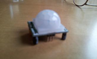

I used a PIR sensor (DYP-ME003) which is very cheap and available form several Ebay sources in China:
Pir_Sensor
Pir_Sensor

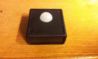

Finding the right mounting method is always difficult, but I found a Hammond box that fits the design nicely:
The Zigbee module is underneath the pcb.
The final unit:
The unit is in a sleeping state most of the time and uses only 0.5 uA power (only the Zigbee hardware, the PIR unit consumes 350uA).
The unit is reporting it's state whenever it changes (waking the Zigbee chip by means of interrupts).
I made the pcb in such a way that it can also be used for a "contact input". In that case the power consumption is really very low and the batteries will last for many years.
