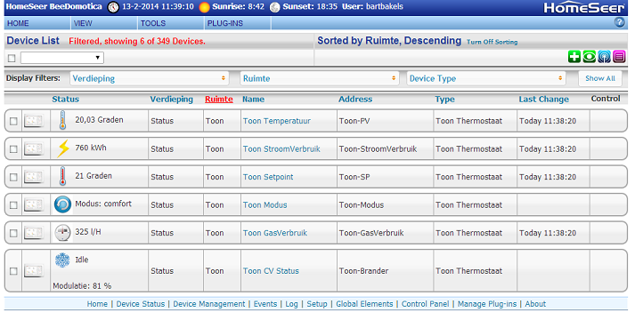

Dear all,
IM getting there. The script now creats and updates the toon devices automatic, and the credentials are now stored in a INI. In addition I posted a screenshot. keep u posted
Screenshot
Screenshot
Regards
Bart

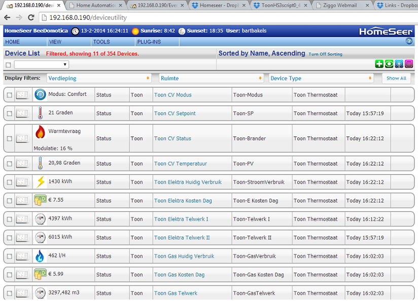

Eneco Toon Homeseer Script/Plugin v0.4 available
Post by bartbakels »
Dear all,
hereby version 0.4,
dropbox.com/s/vay4t6tdmsul77s/ToonHS3sc ... ipt0_4.zip
- Just Unzip the content of the zip to your Homeseer 3 root
- Change the login credentials in the toonscript.ini file in the config directory.
- Create an event which will call the script every X minutes for status updates. parameters; ,
To change mode use an additional event with the parameters; ,MODE
To change setpoint use an additional event with the parameters; SETPOINT,
when the event is run for the first time the following devices are created;
screenshot devices
screenshot devices
:D
I plan to create buttons to change modes, but this is not yet supported in HS3 for my understanding.
Please feel free to comment, give feature request or what so ever.
regards
Bart
