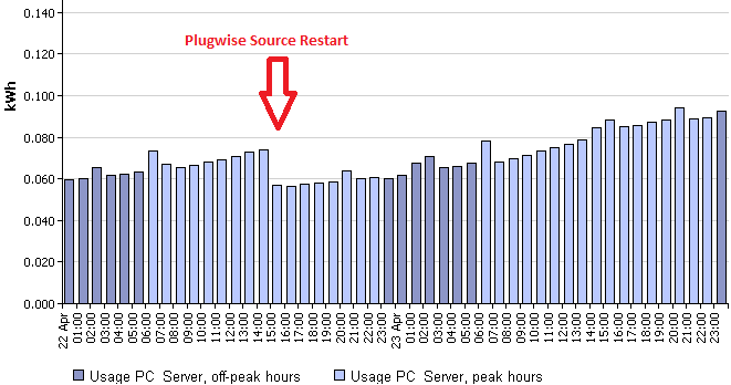

The extreme cpu usage due to the bug in this beta Plugwise, causes an increase of my PC server energy demand of 260 kWh yearly. :D
cpu usage.png (16.33 KiB) Viewed 26401 times
