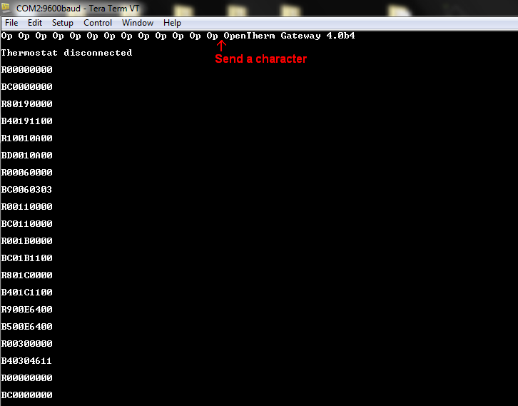

Thank you for the reply, I was in the understanding that the data should be requested with the command and totally overlooked the part of documentation where is told about the unsolicited reports, sorry for that.
I have looked some more into the issue where the OTGW sends the "Op" string continuously. Found out that this is the same reason that the otmonitor tool doesn't 'work'.
This happens in FW version 4.04b.
I used a terminal (TeraTerm) to debug the data.
In this mode the OTGW sends a "Op" string every 1 second continuously, and no other data then the "Op" string is send by OTGW.
The OTGW will enter this mode after it received an UART break, the break is in this case 1500 us long.
(for the otmonitor tool I use a USB cable as virtual COMport which probably causes some static when I plug in it in, I can imagine that this is seen by the OTGW as a 'break')
If I send any character (using my terminal) to the OTGW it stops this mode and it boots again and works as expected, this also applies to otmonitor which now will read the unsolicited reports and translates them to readable.
A printout of my terminal:
Posts: 2031
Re: Self programming mode
The only way I can come up with that could explain that situation occurring is if the serial line doesn't go all the way up after a break (i.e. stays below 4.5V), until you send a character.
As I have also concluded from another thread, my current attempt to handle a continuous BREAK state on the serial line apparently isn't good enough. I am going to have to devise a better way.
