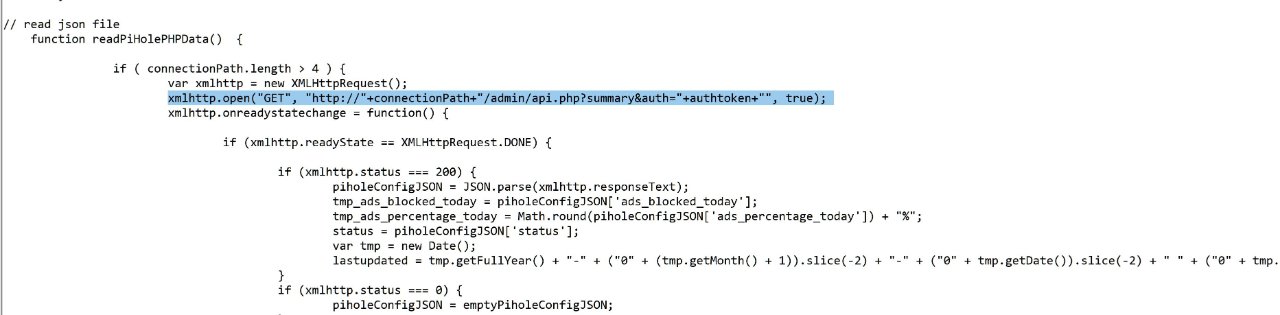

flamingbob
Posts: 38
Joined: Wed Nov 23, 2016 4:11 pm
Re: Toon app: PiHoleStats
Post by flamingbob »
Had the same problem with my toon.
Trick is the auth token and changing the URL in the qml to this:
xmlhttp.open("GET", "http://"+connectionPath+"/admin/api.php?summary&auth="+authtoken+"", true);
Then it all works perfecty.
Need to see how to detect an empty auth token though since pihole also works without a password and so without a token.
EchoNL
Posts: 24
Joined: Sun Jan 10, 2021 1:06 pm
Post by EchoNL »
flamingbob wrote: Wed Jan 11, 2023 2:26 pm Had the same problem with my toon.
Thank you very much! :) :)
Instead of using the password (which always worked in the past) i used the API token to login and changed the url in the qml file.

EchoNL
Posts: 24
Post by EchoNL »
Login Winscp
Change URL in folder:
qmf - qml- apps - piholestats-0.1.13 - PiholestatsApp.qml
to
Open folder
mnt - data - tsc - piholestats.userSettings.json
Enter Auth code + pihole adres. The API token, you can find at your local Pihole adres:
Open Settings - API - Click show API Token
