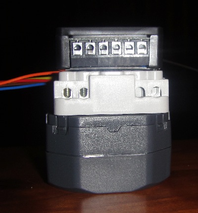

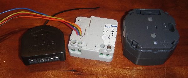

First test result of the Fibaro Dimmer and the switch.
Modules are compact compared to Duwi.
PRO:
Small
Will fit behind existing switches
Modules works fine in Homeseer
CON
Lot of wires behind a switch It will be challenge for fitting it in 40mm
Homeseer Association for status update is not working will test this a bit more..Poll works fine(Documentation ,,,Groupe3 -> Homeseer)
3KW Switch will show 2 switches in Homeseer (must be 1)

Do I understand correctly that the Fibero will fit behind a standard wall switch? (Apart from begin an installation hassle)
Did you try it yourself already?
Thanks
Olof
Patrik.b
Posts: 15
Joined: Thu Mar 17, 2011 7:13 am
Location: Finland
Re: New Zwave products from Fibaro
Post by Patrik.b »
I have tested the Fibaro dimmer insert. It fits behind the standard switch, and it works fine with Vera2
