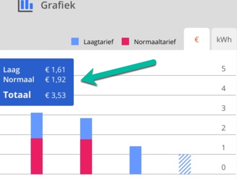

Hello,
On this from you see it is not possible
I Rooted my Toon but in my case I see the price:
Is there a place in Toon to enter the real KWH price and GAS price?
I don't know why I see the price, maybe it is someting before rooting I never was a customer of Eneco.
Thanks.

Posts: 1918
michel30 wrote:Hello,
Thanks.
Yes, there is: /qmf/qml/qb/base/Globals.qml in the top section.

Posts: 288
Post by michel30 »
Hello,
Super thanks, that works for me :-)
