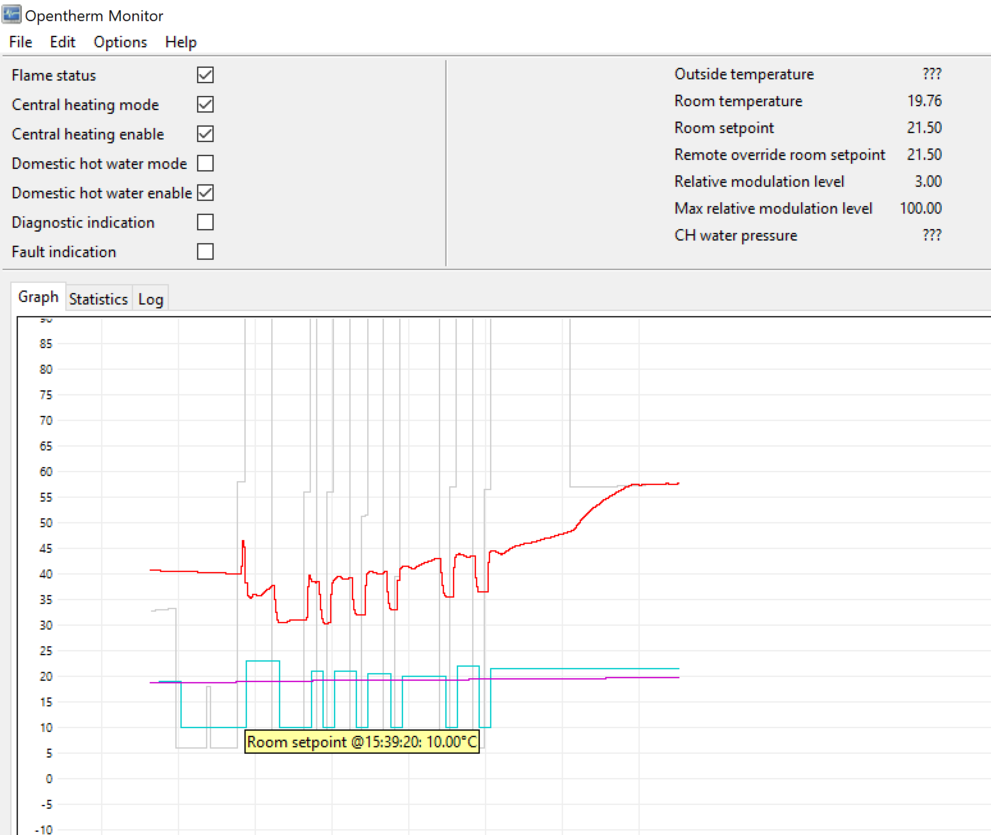

Using `otmonitor` I do not seem to have the connectivity issues, however, I do notice something that also occurs when using the Home Assistant integration, namely, after each set control temperature command, the temperature resets to 10 degrees (see attached screenshot) before turning to the correct temperature.

Can anyone tell me if this is expected behavior or not? If not, how can I solve this problem?

Yes, this is the expected (necessary) behavior, as I recently explained here: viewtopic.php?f=75&t=12623&p=92797#p92791
