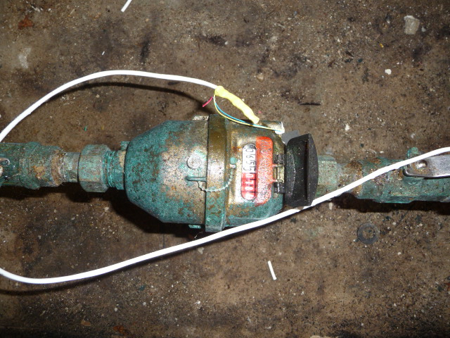

I have the same meter as you have and you can measure the water usage.
There is a small black cover (not the one covering the numbers). Take it out and you have 2 holes. (I think I see it 1 cm to south west of the orange mark.)
Put a reed contact into one of the holes and you get a pulse every 0,5 liter.
I tried to find the original reed contact but it's hard to get. You might as well buy a really small reed contact from Conrad.
http://www.conrad.nl article 502036
It's not cheap but it's better than replacing the water meter. :D
good luck.

JayBee wrote:@ Janseb,
good luck.
I can confirm the above works fine.
regards, the other Jeroen ;)

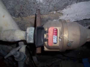

I have fond the hols to put in the readcontact it is on the right side of the red numbers
approximately half of the meter
I will try to make a picture this evening

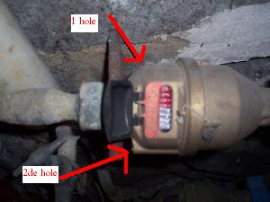

anoder option look on the photo i have indicated on the photo
mine is on the site of the red numbers dis photo is the old type of water meters

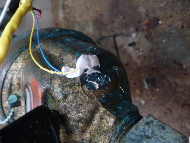

In my meter the 2 holes are right next to each other. One hole is for the reed contact and the other hole is used to fix the housing of the original reed contact.
However if you buy a normal reed contact (eg. from Conrad) you don't need the second hole.
You might have to test how deep to insert the reed contact by opening the watertap and measure if the contact opens and closes while water is running.
**Jeroen**

Attached 2 pictures of my setup.
JeroenKl
