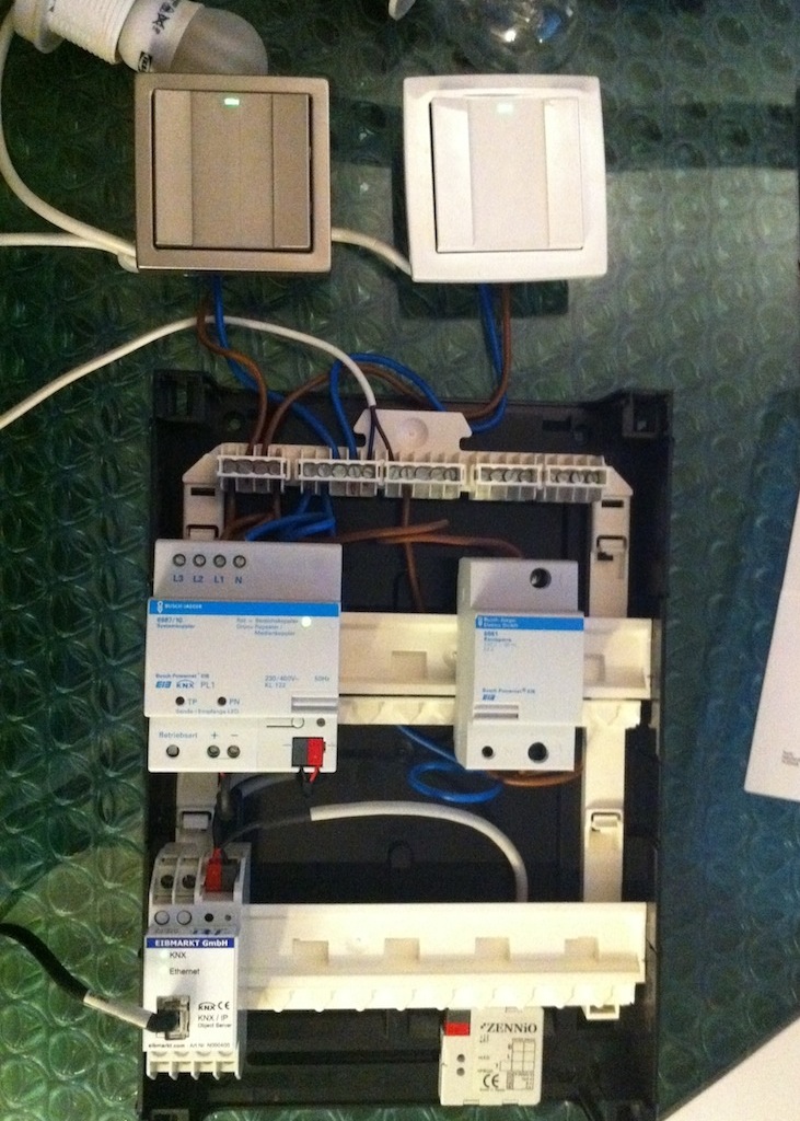

I have put the components in an ABB jumperbox to make my PoC easy to handle and more safe:
To program the devices in the KNX bus I have ETS3f installed in a virtual, it uses the IP BAOS to connect to the KNX bus.

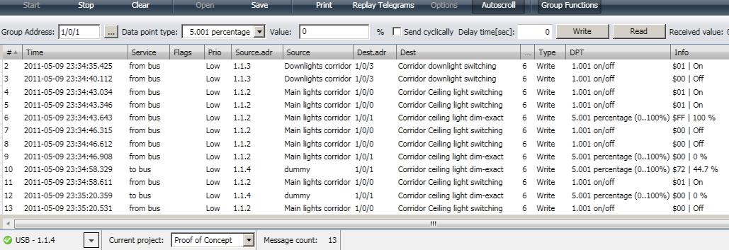

The new ETS4 software has a nice "Group monitor", this works the same as the PMIX35 Xanura software. The only thing is it is way nicer.
Screenshot 2011-05-09 at 23.36.43 .png (136.43 KiB) Viewed 12375 times
I've set up the PoC with 2 components, a dimmer (1.1.2 = Corridor main light) and a switch (1.1.3 = Corridor down light). I will be using a third object to connect to the bus with the PC (1.1.4 in today's screenshots).

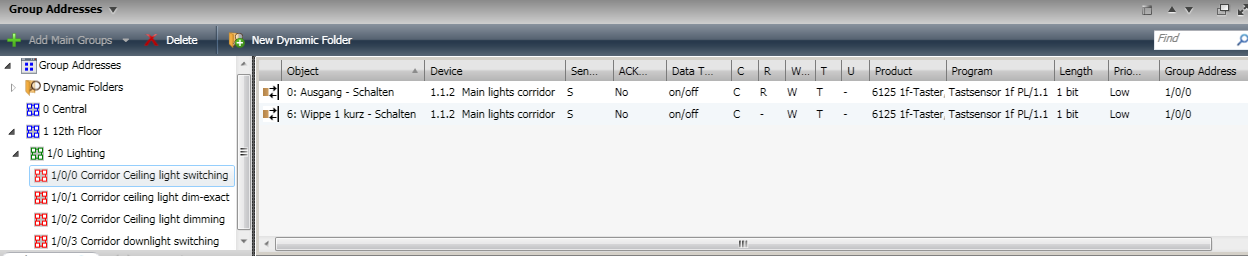

Each of these components should be placed in to a group object. Each group object is an action. So for the PoC I've made these group objects:
1/0/0 Corridor main light switching (used for on/off)
1/0/1 Corridor main light dim-exact (used to directly set a specific dim value)
1/0/2 Corridor main light dimming (used to manual dimming)
1/0/3 Corridor down light switching (used for on/off)
To give you an idea on how that looks in ETS4:
Screenshot 2011-05-09 at 23.51.35 .png (64.07 KiB) Viewed 12375 times
As you can see in the screenshots we are now able to switch the lights and send some fixed values from the PC.

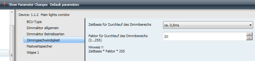

I've found the problem. The dimmer was actually working but it took 8 minutes for a complete dimming cycle. This results in thinking it doesn't dim.
After some adjusting of the dimmer parameters it now works. However these Powernet dimmers have a strange way of doing this calculation. New dimmers just have a single parameter... how many mSec for a complete cycle.
Screenshot 2011-05-12 at 15.21.06 .png (32.72 KiB) Viewed 12344 times
